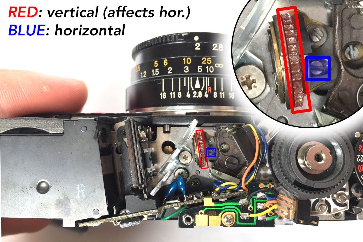

Встретил в ФБ, решил тут оставить.
Инструкция по снятию верхней крышки: http://justinlow.com/articles/repair-minolta-cle
Описание регулировки дальномера на аглицком:
Minolta CLE rangefinder adjustment.
An already-written guide exists at this link for top cover removal: http://justinlow.com/articles/repair-minolta-cle
There is a rangefinder adjustment access plug (small black circle) on the top next to the hotshoe. However, for anything more than horizontal adjustment, top cover removal will be necessary.
If Vertical Adjustment is necessary, perform that first.
There is a circular prism on the red ridged element. There is a notch in the adjacent metal plate. There should be a blue dab of thread locker from the factory. It must be dissolved with appropriate solvent. Rotating the ridged element forward/backward will shift the rangefinder patch up and down, but also a little left or right. Be careful not to apply much downward force.
Once vertical adjustment is satisfactorily performed, turn the slotted eccentric post to slide the patch left or right. Very minimal movements are required. The post sits on an armature that moves, and be careful not to apply much downward force. It will move a bit forwards/backwards but that's normal.
Test rangefinder on a very far away object, confirm with ground glass on the film plane at closest focus.
4EC4FF29-27BB-4F91-AEFD-EF29EF73832B.jpeg [ 272.08 КБ | Просмотров: 9104 ]
СообщениеДобавлено: 09 авг 2019, 22:09  Заголовок сообщения:
Знакомое колесико. На гексар рф тоже самое. Чуть сильнее нажал, камера в сервис собралась.
