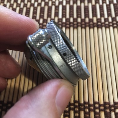

024130E5-EDFC-431F-8704-F3FCB9E810D8.jpeg [ 176.12 КБ | Просмотров: 16038 ]
Rear elements came out easily and they are cleaned already.

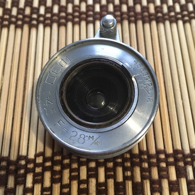

BA444C1E-C984-4CE1-B8D7-09CCC519C384.jpeg [ 165.19 КБ | Просмотров: 16038 ]
But as usual I’m not good with lenses and I’m stuck to access the front lens the aperture mechanism to be cleaned. There are two screws here - next photo - and a retaining ring as shows the previous photo.
Also another hidden screw which hole is located at the focusing thread...

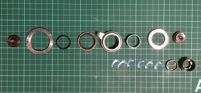

2019A5AB-7A38-41AD-A23A-89B7FCEE9E75.jpeg [ 139.59 КБ | Просмотров: 16038 ]
Any help how to continue will be appreciated :)

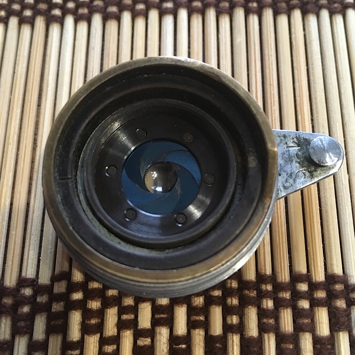

57AB7304-2238-498E-AE52-DCD2A67806EE.jpeg [ 318.76 КБ | Просмотров: 15749 ]
Done! Finally just by myself :)
Lens is mounted back, all lenses surfaces cleaned, aperture tube lubed a bit and two nasty screws head flattened for an smooth aperture movement.
Now shooting/test time!! :)
